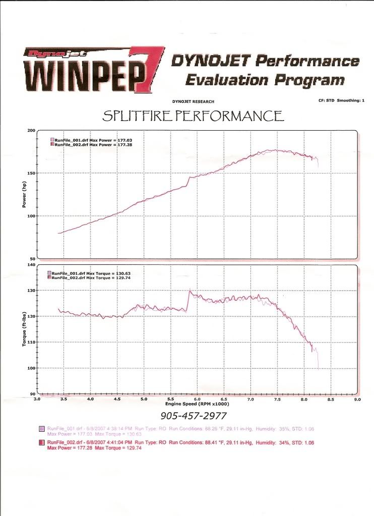

After my first dyno about 6 months ago I posted my first thread:
http://forums.clubrsx.com/showthread.php?t=500474
For that run I had actually had these mods on my 2006 Acura RSX type S
DCRH
ESMM
Tanable Hyper medallion
AEM V2
The outcome was disappointing, but I knew there was room to improve. 177whp, 130tq.

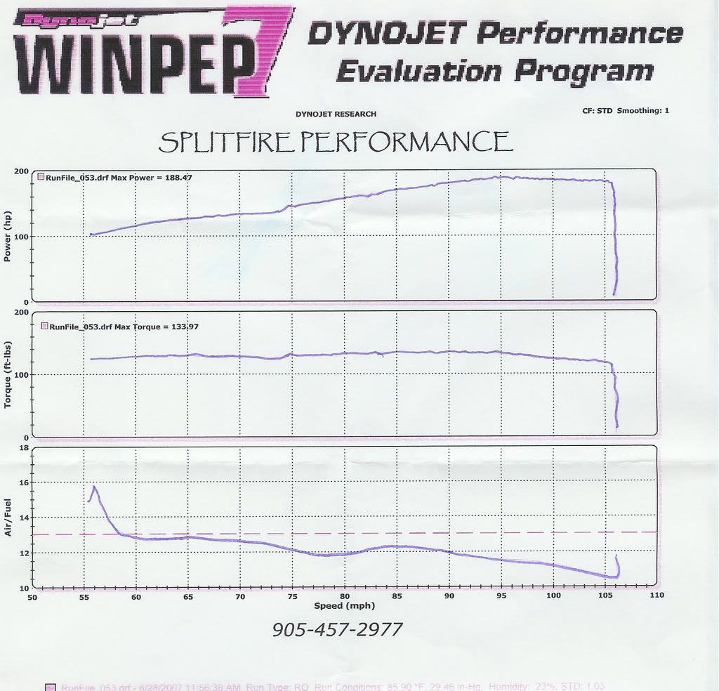

Alrite, so that?s a good basis point from which to start. So 4 months after heat soaking like a mofo, I thought it was time to upgrade my warm-air intake into something a little better and head to the dyno one again.
Mods: DCRH, ESMM, Fujita F5 CAI, IMG, Tanable Hyper medallion
Link to this thread: http://forums.clubrsx.com/showthread.php?t=507546
The outcome was the only rewarding thing my car has given me over the last year and a half to be very honest.
***Note that this run to was done before k-pro!
Dyno: Image
The outcome was 188whp, 133tq.
So I looked at the AF ratio on that dyno and decided that a k-pro and a good tune could only keep my going faster and break 200whp like EVERY OTHER PERSON ON CRSX or anyone with a K20 for that matter.
