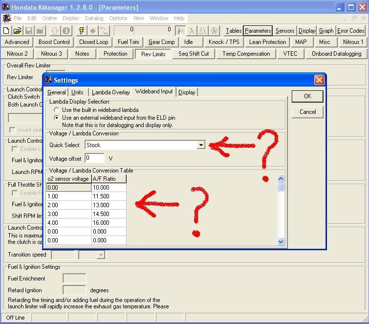

Next I need to change the settings in Kmanager.
Now, 3 questions;
* What should I choose at "Quick select"?? Because I can't find my a/f meter there.
* The voltage table is it enough like that? Because the voltage a/f is linear. Or do I need to fill it in more specific?
* Last one: Voltage offset, do I need to let it on 0V?

1. Select Custom from the quick select combo.
2. If the voltage / AFR is linear you don't have to fill in all the table (filling in all the table won't hurt, I did it that way).
3. Look at the gauge and AFR in the KManager at the same time. If both are showing the same AFR then the Voltage offset should be 0, else you should find out what offset works for you.
The aim is reading the same AFR from the gauge and KManager.
There is a simple way of doing that for AEM UEGO. I pull the sensor plug out and the gauge shows 14.7. Then I check KManager to see what AFR it is reading. Then I start to play with the Voltage offset untill I see 14.7 in the KManager display.
If you don't have that option, you can do this:
Let the engine run for 30 seconds, stop the engine, turn the ignition on (don't start the engine), start datalogging (press F10) try to set the voltage offset. Since the AFR changes quickly while the engine is running, this method will be more accurate.
I hope this helps.
Good luck :)

I finally connected my wideband to my ecu today.
I just needed to cut the ELD wire and connect it
to the A/F meter wire.
Changed a few settings in Kmanager and that's it.
