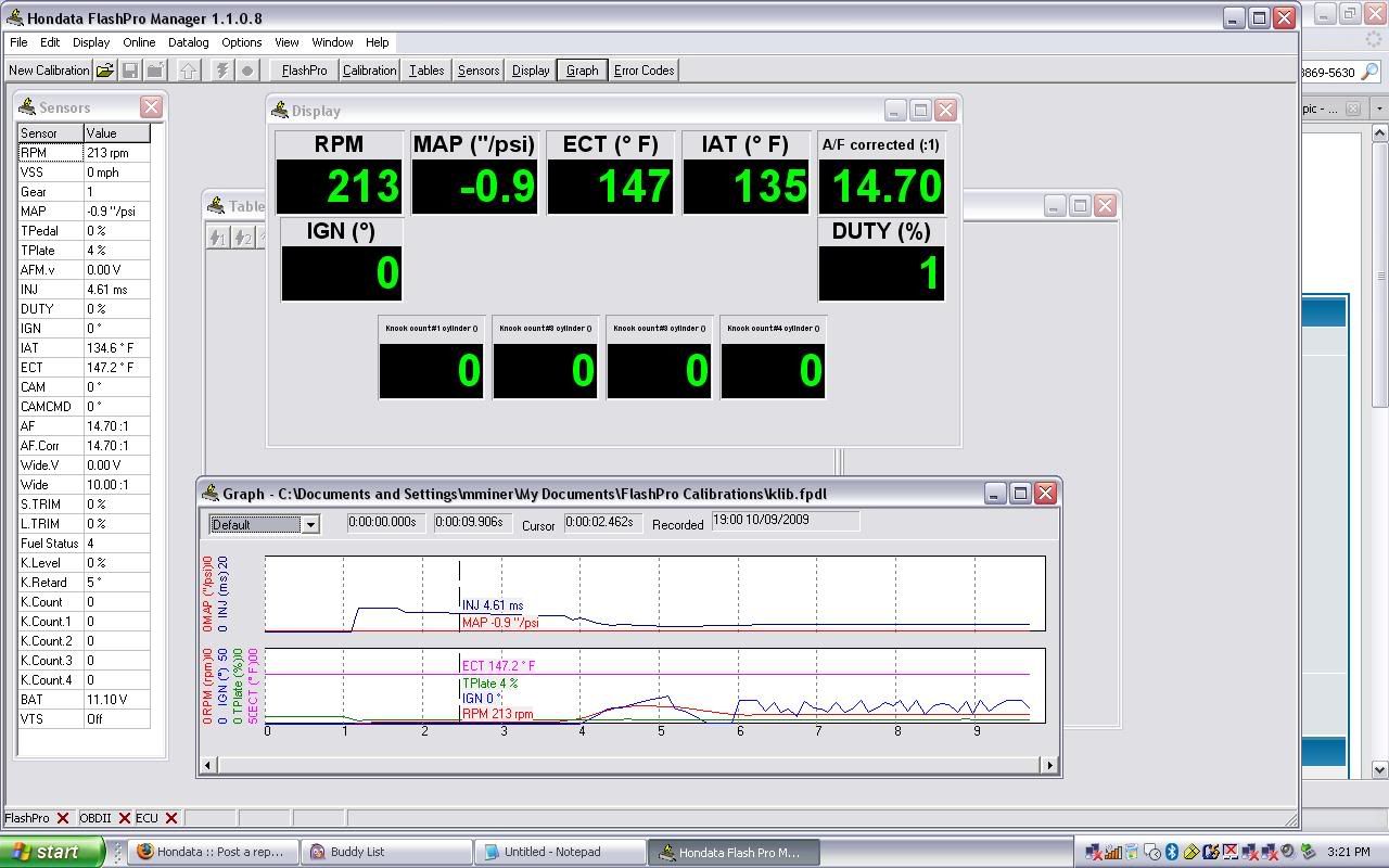

Here is the datalog, and some pictures for people that dont wnat to open the datalogger :)
Cranking starts at about 1 second, car begins to start just before 4 seconds and takes another half second to 'clear itself up'
M@
