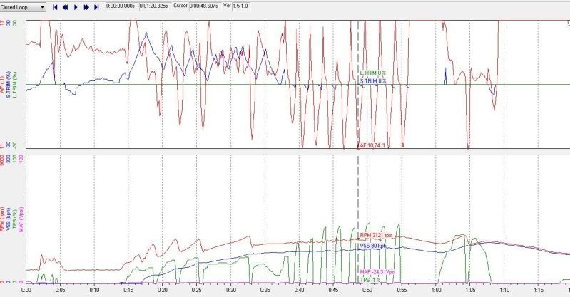

The car is running fine but I have very rich spikes after changing gears or intermitate acceleration and deceleration. Is this normal in closed loop? Open loop seems fine.

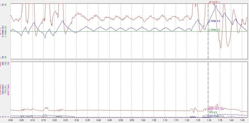

I have another issue after could starts (closed loop), when I try to put very very light throttle TPS 4% the AFR goes wide lean and the car hesitate, almost stall. If I leave the pedal TPS 0%) or accelerate further the AFR turnes in to the "range"

here are the logs:

Re: AFR 10,7:1 spikes in closed loop
Why are your MAP and TPS changing continuously?
retroid
Posts: 35
Joined: Sun Feb 22, 2009 4:25 am
Post by retroid »
on this part?
I was hitting the gas pedal, just to evidence the low AFR spikes on very fast TPS changings. Is this normal? A small amount of unburned gas hits the exhaust and generate this "short" AFR figures?
Posts: 24347
There may be spikes at throttle tip in, this is pretty normal

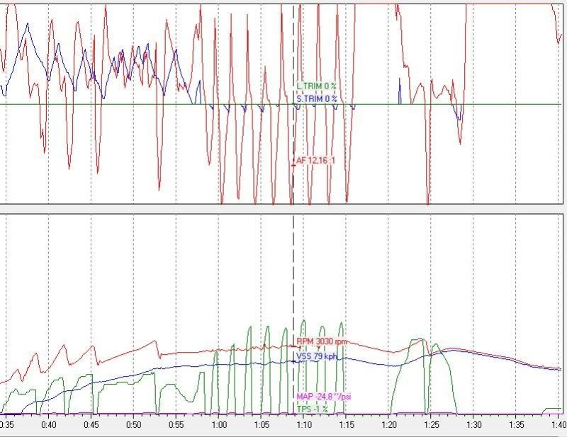

Post by retroid »
yes, on street and dyno (not by me of course) :)
car runs ok, I'm only triyng to understand the nature of these "sparks".
a better zoom look. I think there are the inertial gases resulting from the abrupt tip-out, so normal condition....

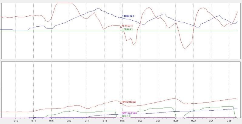

That is tuning related. Look at the short term fuel trim right before you let off and you will see that it is adding up to 14% fuel and then you suddently let off it still wants to add that fuel for a split second. I would have your tuner take a look at this.

Post by retroid »
Ok! I was looking at the other datalog. the specific moment:
so, in a "perfect condition" once the TPS goes instant from 100% to 0, the S.TRIM also should decrease instantly?

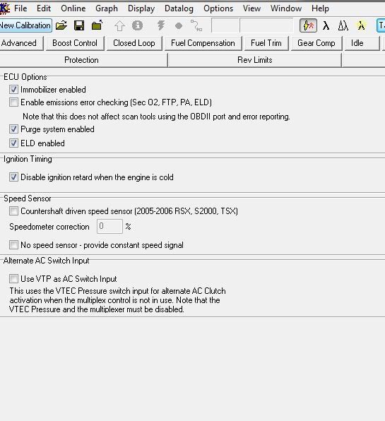

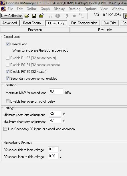

I found another strange thing. I have the emissions error checking disabled (OBD II, secO2, PA , etc) but the secO2 enabled.... Is this ok?
many thanks! I started to study all the kmanager/k pro training and now I begin to understand it much better.
