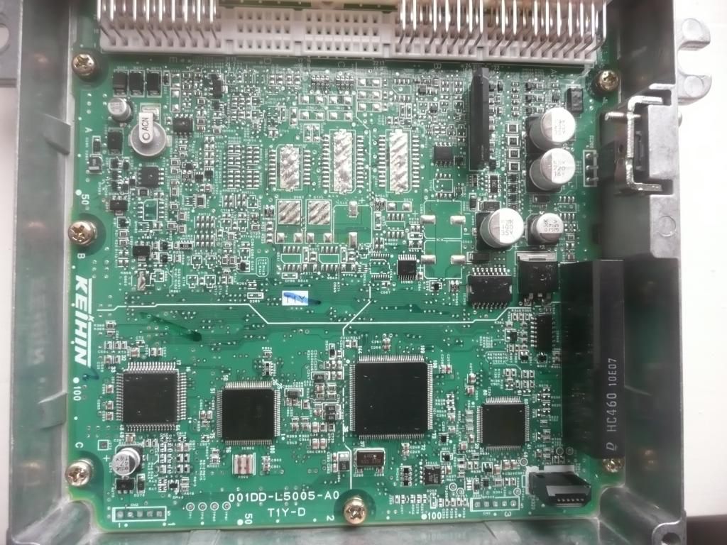

Post a picture of the inside of the ECU.

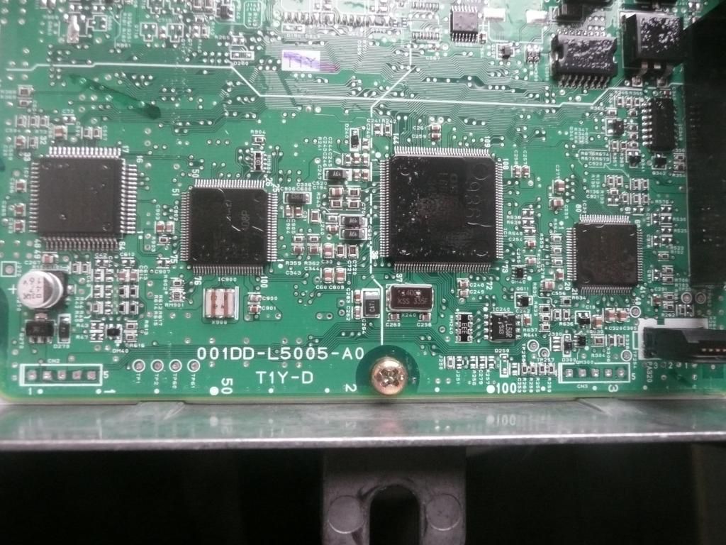

Okay! Here goes nothing, i guess its going to be bad news...
Think this is the important bit:

It looks compatible, but without knowing more about the vehicle and the code inside the ECU, there may be some things that will not function correctly and there may be errors that cannot be disabled.
