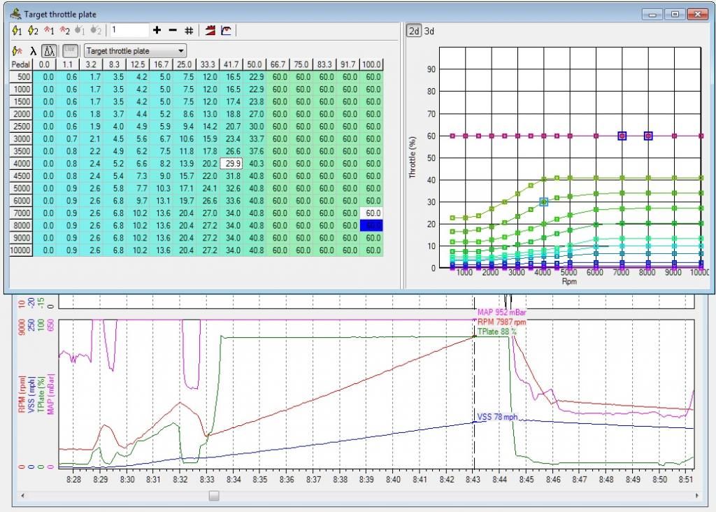

The S2000 may be significantly different in the way the table values get applied, so you will need to experiment with the max value for your car. However, below is a screenshot of my throttle map and resulting datalog. Note that my actual throttle plate is 100% open when it shows 88% in the datalog.
Basically, 60 in the table results in 88 in the datalog, which is 100% on the actual throttle plate.
