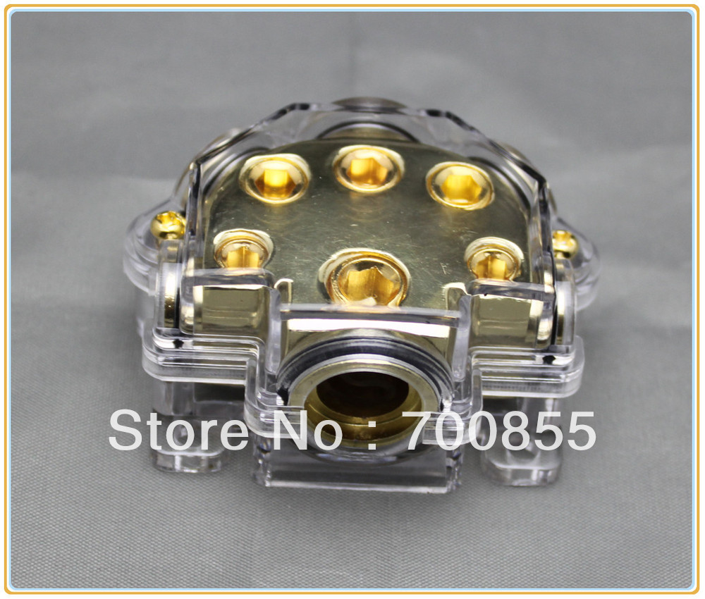

I'm using OEM Miata wires and they seem to be around 4 AWG and I do have a T in between battery/starter/alternator (alternator wiring is going through OEM miata fuse box)
alternator wire is around 8 AWG and starter wire is off of K20A2 charging wire.
For the T I'm using a distribution block, looks very similar to one of these.

Posts: 10665
Re: Voltage fluctuation and daughterboard connection problem
The alternator wire needs to go to the battery. If you give me lengths I can recommend wires sizes.
Even very slight resistance at a connection is a problem when moderate currents are involved. That's why I suggest crimped and soldered connections with no joints.
