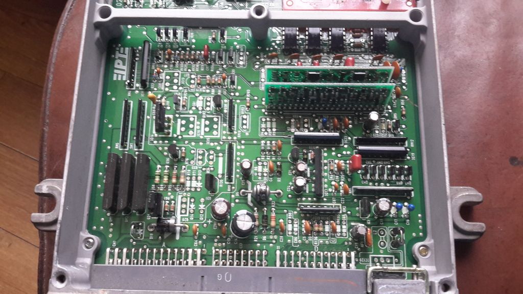

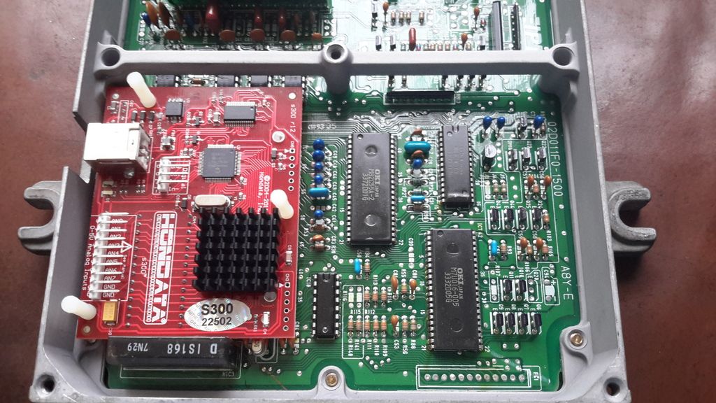

Re: Hondata s300 solid cel, no start.

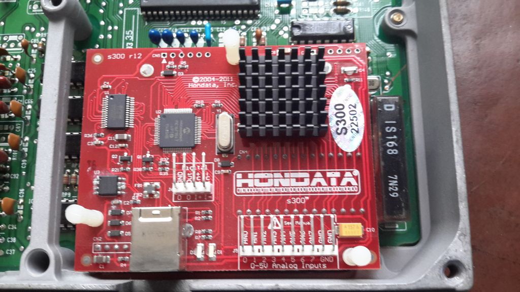

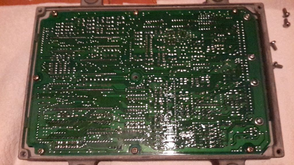

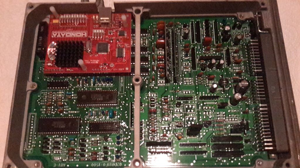

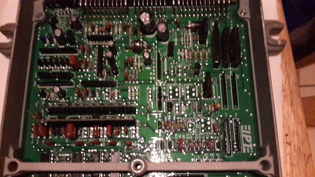

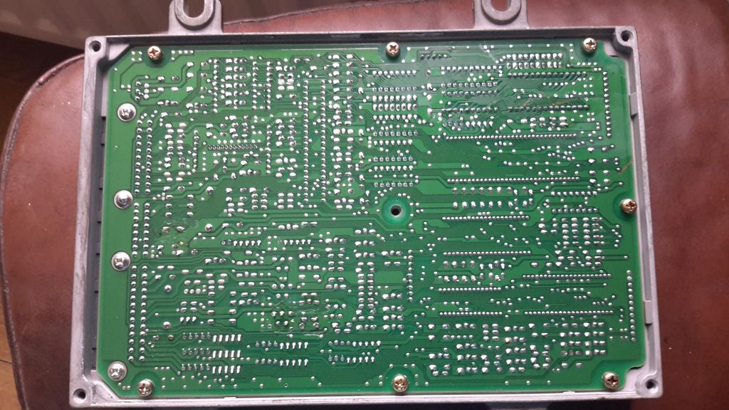

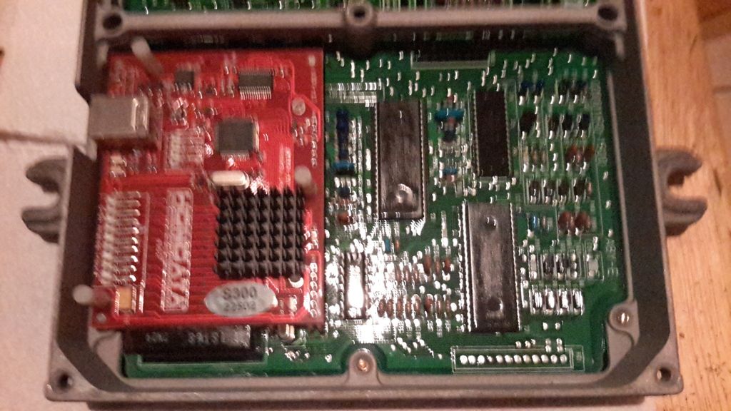

Post a picture of the inside of the ECU
RooneyRocket
Posts: 11
Joined: Fri Feb 08, 2013 9:00 am
Post by RooneyRocket »
RooneyRocket
Posts: 11
Posts: 24345
The capacitors all look original, so that is something to consider. I would recommend that you try the s300 in a friend's ECU that has s300 to see if it works in their ECU.
