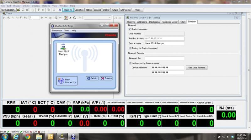

Hi
I can't seem to establish a Bluetooth connection between my new flashpro and iPhone 5. No luck on my iPad too.
There is no issue with android devices. I was able to make the connection with android.
Please advise!

The Bluetooth settings are default. I did not change anything. Flashpro Bluetooth is definitely enabled.
The issue is my lap top running windows 7 and samsung note 2 running kitkat are able to detect the flashpro. iPhone 5 running ios7 totally cannot detect.
Does this have anything to do with uploading calibrations first? Issue is other devices are able to detect except for iPhone 5 only even though calibrations are not uploaded.
Bluetooth connection to my laptop is possible:

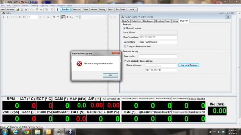

Abnormal termination when i clicked 'Use Local Address':

Posts: 10649
Re: FlashProManager V1.8.3 beta (Bluetooth)
Android uses Bluetooth 2.1/EDR. iOS, thanks to Apple's restrictive policies, has to use Bluetooth Low Energy, which works a little differently.
Sometimes Bluetooth Low Energy takes a little while to find the device. I would reset the device name to something short and without punctuation (eg 'FlashPro') and set the PIN to 0000 or 1234. Then reboot both the FlashPro (by unplugging it) and the iOS device. The exception is because there was no local Bluetooth radio to get the address.
