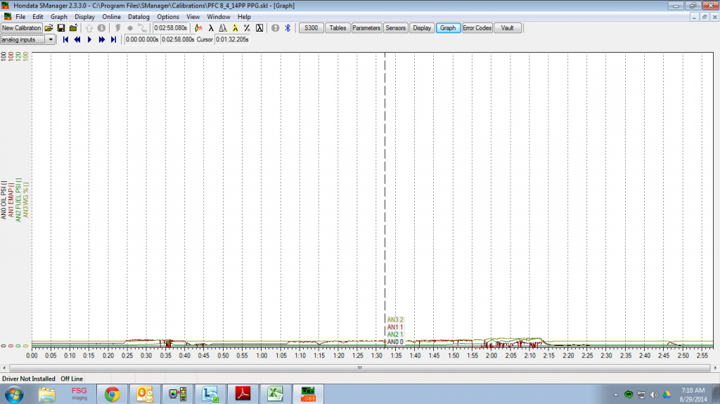

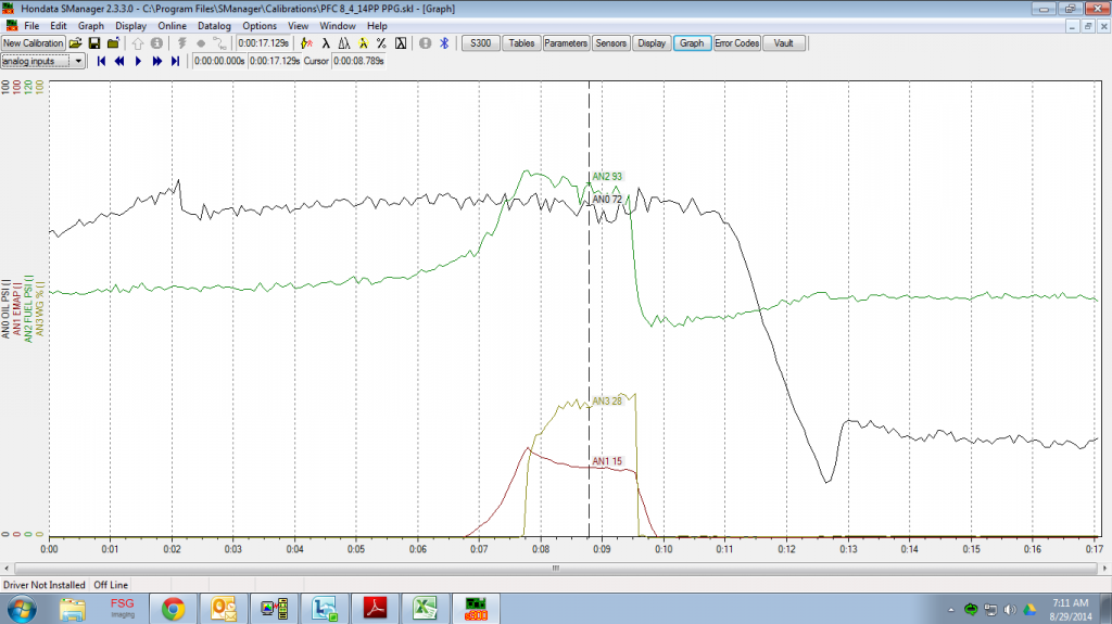

It does not look like you have the analog inputs set up correctly in the calibration as they are set up as numbers instead of pressures, percentages, etc.
The one you have labeled as not working the graph appears to have data, the one you have labeled working does not have a whole lot of data in the graph.
mo_spec
Posts: 31
Joined: Sun Oct 14, 2007 5:07 pm
Re: Analog input sensors working/logging erratically
Post by mo_spec »
I do have them set up as Numbers, that shouldn't affect how they log. I mean if it did affect how it logged i assume it would be wrong all the time, not working sometimes and failing other times. Here are 2 screen shots from the logs I posted before, no settings were changed between the two logs. The only difference is the first log was taken on board with the switch to activate, and the second was a pc log.
