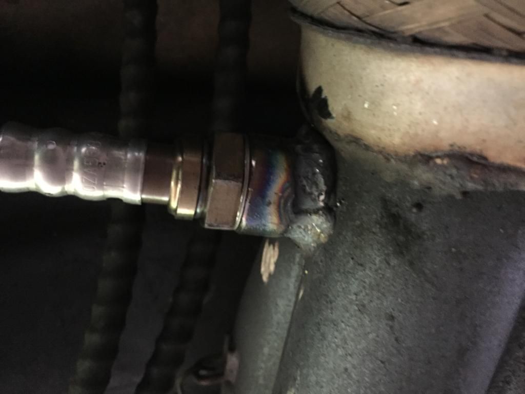

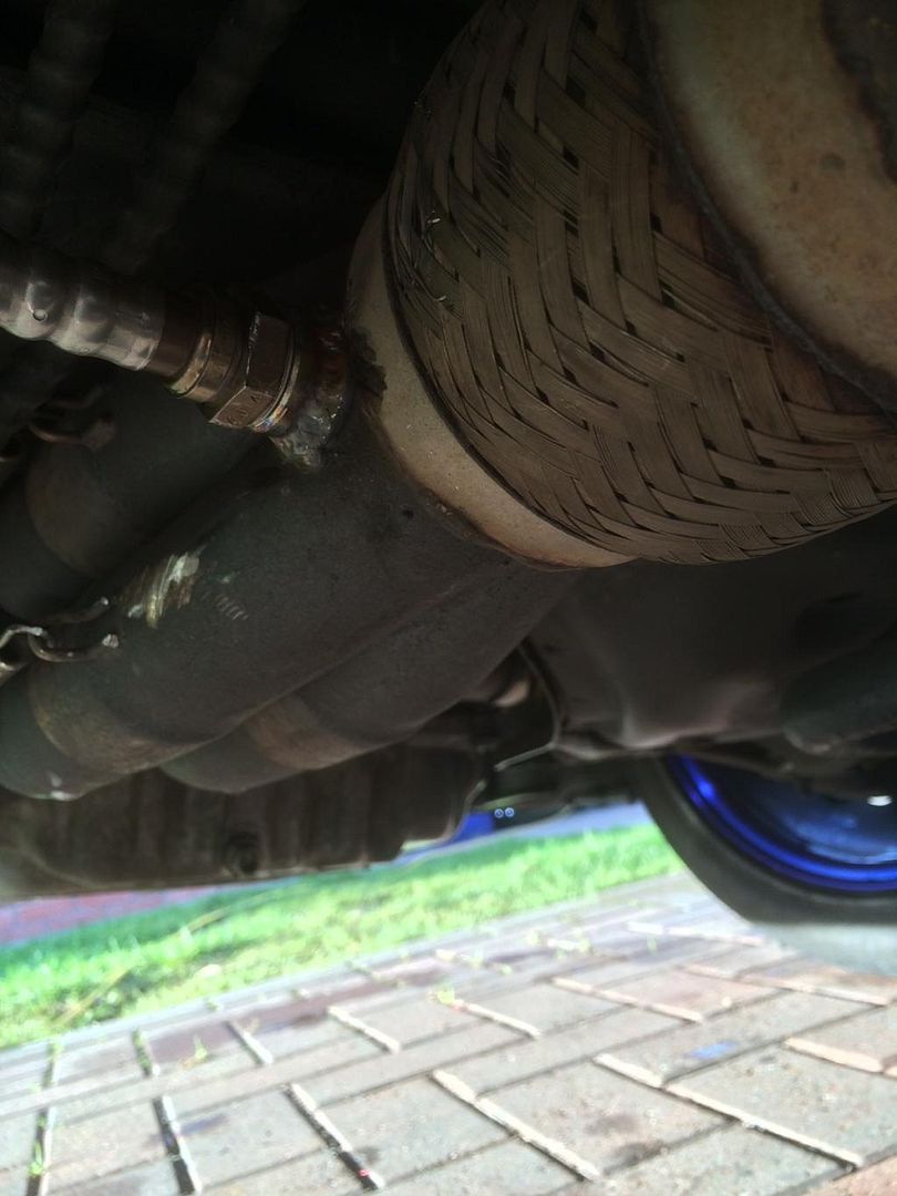

However, I'm starting to wonder is the sensor far enough into the exhaust flow? I had to have the sensor thread welded in to take it and maybe it's too deep of a thread so the sensor isn't getting a good enough reading?
I've attached a pic:
Thanks
Dan
Posts: 24372
Re: K Pro/narrowband closed loop issues
That bung may be part of the problem.

Sorted!! It's finally working :D :D :D
I've attached my data log.
It was the bung. I got my welding guy to replace it with a much shorter one and it's all working fine now with no errors at all and trimming perfectly.
