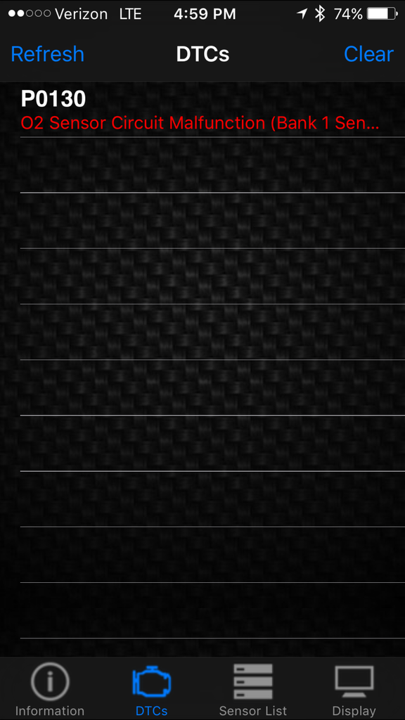

Been using the S300 since last Friday when I got tuned. Last night while cruising, I got a MIL light with the code P0130. It's odd, because it's an OBD2 code. This was approx 50mph, maybe 2-2500rpm's, in 5th gear. Light load.
Unfortunately, I do not have a datalog of the event. I can provide my tune file, if necessary.
2000 Integra GS-R
P06 ECU - OBD1
Any idea on why an OBD2 code would show up? It hasn't come back...yet.
Posts: 10665
Re: P0130 - O2 Sensor Circuit Malfunction (Bank 1 Sensor 1)
The s300V3 maps OBD1 error codes to OBDII error codes. P0130 is 'oxygen sensor A'.
