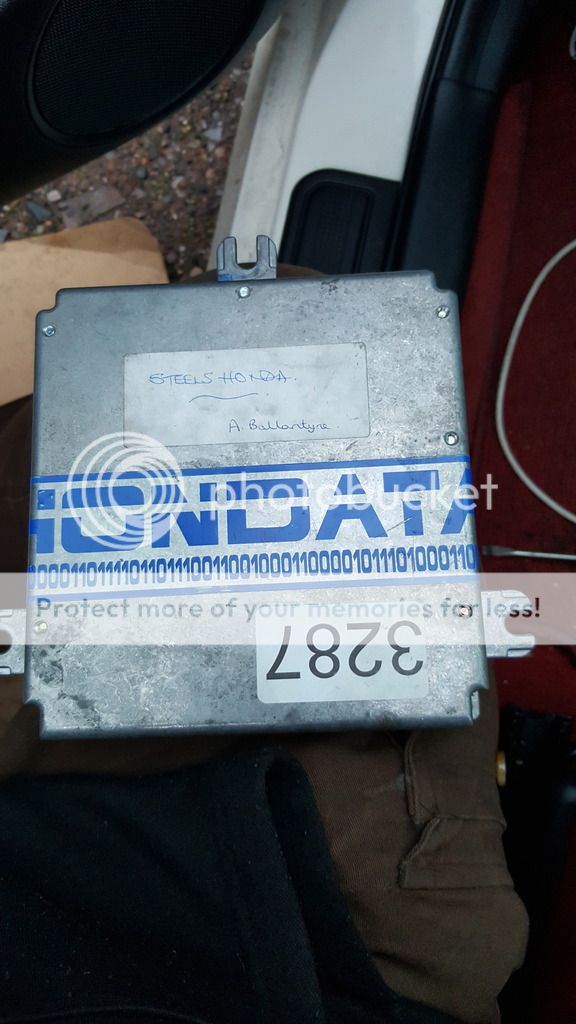

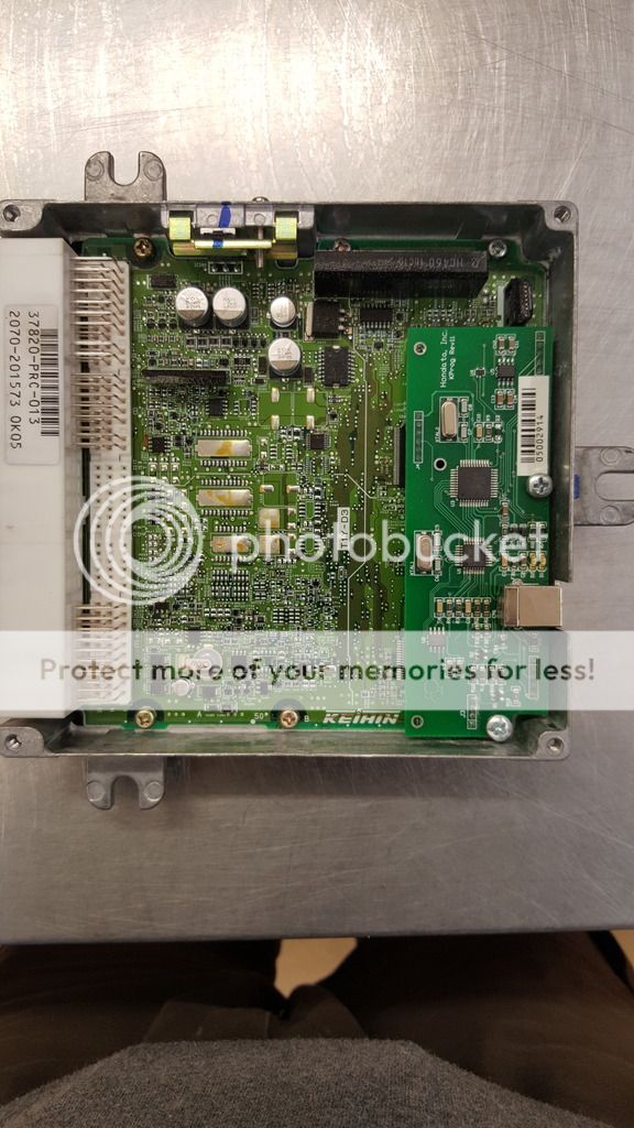

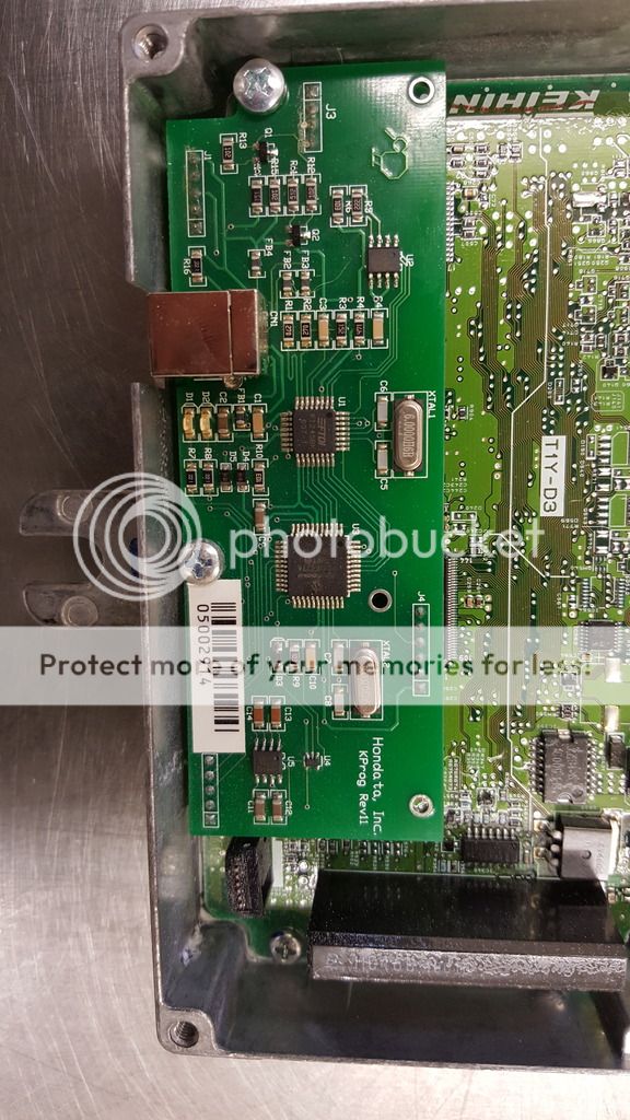

Now the Ecu is looking like its a PRC one which it should be I think for a dc5, and it has a hondata Board in there too. See pics..

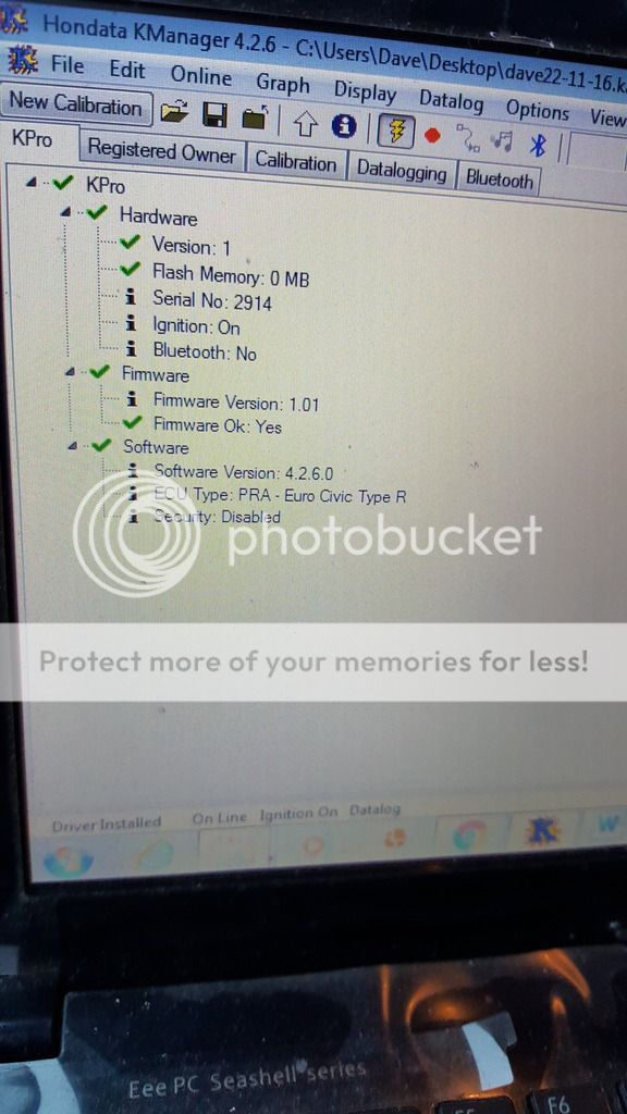

Now the weird part, when i go into Kmanager and click on the Kpro tab, it says it is for a euro civic and is a PRA ecu. Which would make sense as PRA doesnt support wideband.

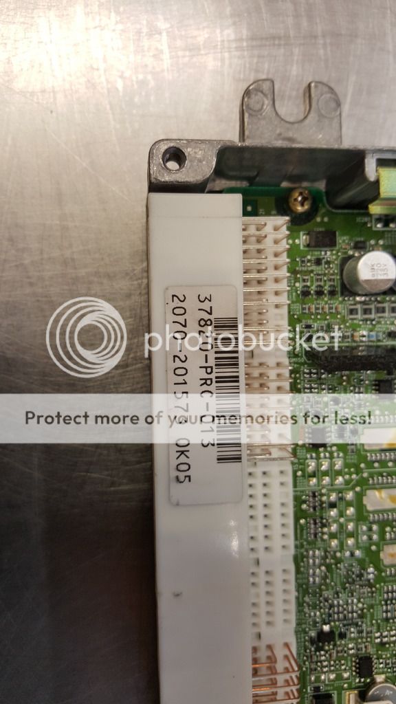

But it doesnt appear to be a PRA one from the markings on the serials etc on the ecu.
I looked on the Hondata website to make sure it wasnt a counterfeit one, and as far as i can see it doesnt appear to be.
Coule it have the wrong software installed on the ecu, or could the board of been swapped or something? Its got me stumped...
Is it possible someone could tell me from the serials etc what it is / should be?
Iv attached pics...

It appears that someone has loaded a PRA calibration into your ECU. I would just load the closest PRB calibration and upload to the ECU.

Thanks for getting back to me, that does make sense. I will have a look at this.
Could you tell me if there is then a way to then import my map settings off the PRA map into the PRB one or would i need to enter all of the values manually? Or would i be best to have a new map doing at the tuners do you think?
Thanks again i appreciate your help.
Posts: 10665
Re: Weird Kpro issue. Dc5.
You can copy and paste the main tables (fuel, ignition etc) but there will be differences in how the PRA & PRB run the engine.
