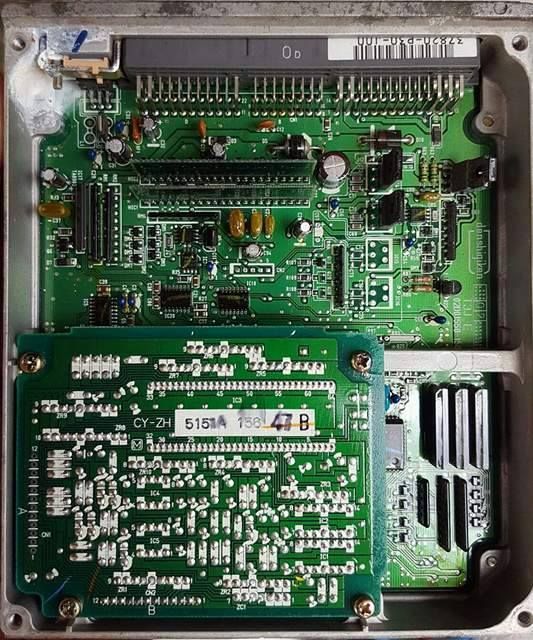

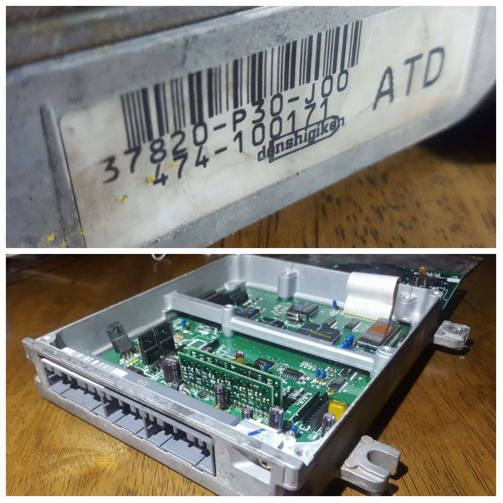

newbie here, just need to clarify some procedures on the install for s300j on a JDM 37820-P30-J00

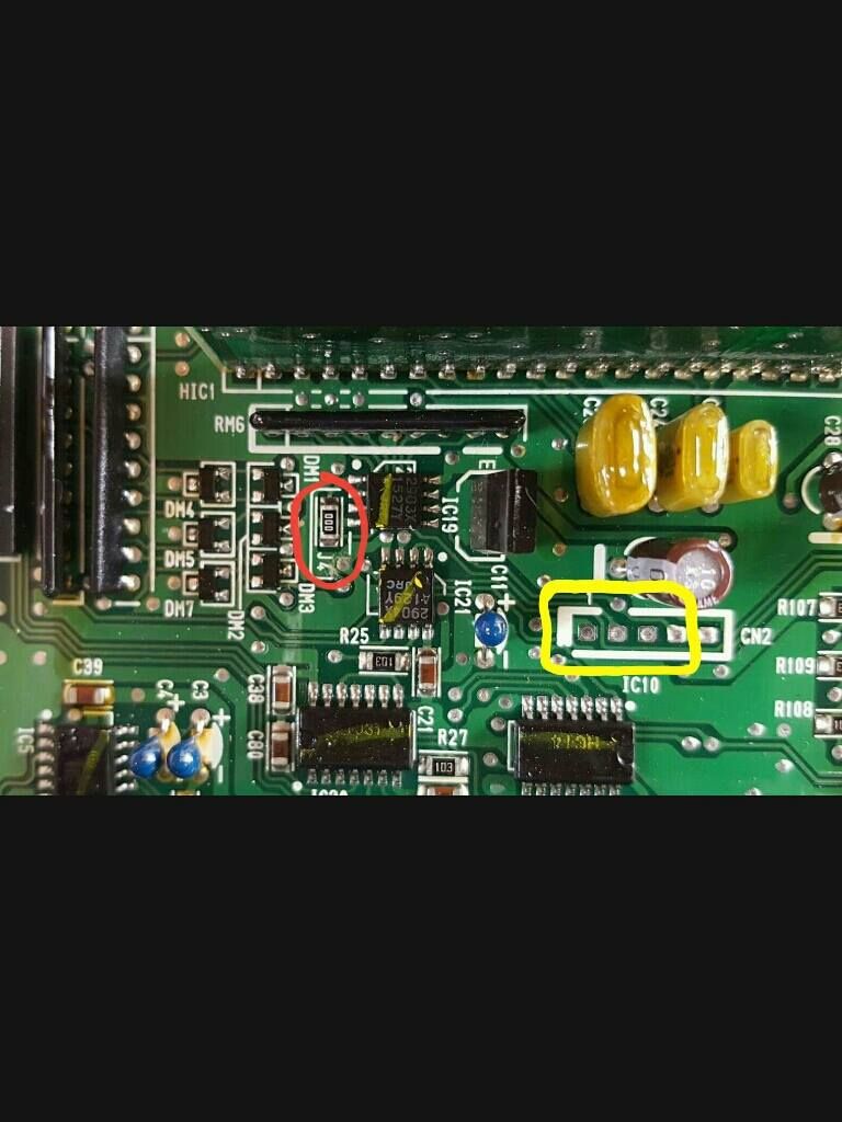

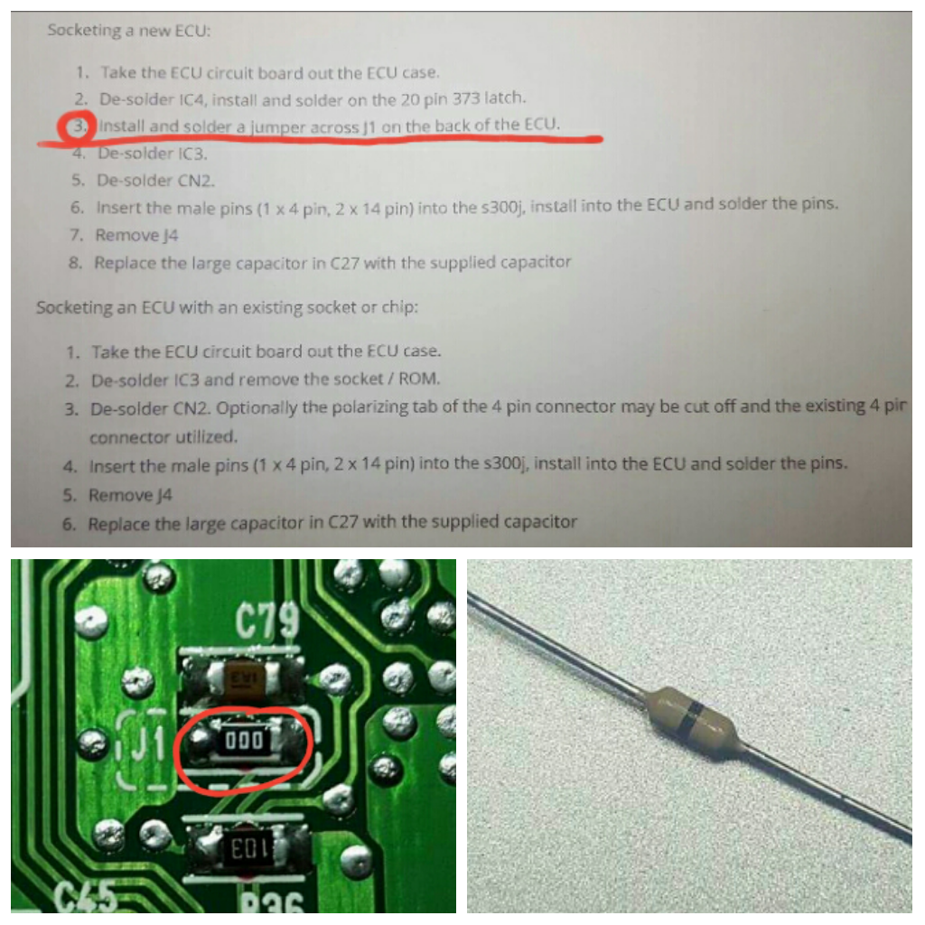

1. On J1 Do i need to remove the (surface mount 0 ohm resistor) or just leave it there and solder the jumper above it.
2. On J4 just removal of that part and on CN4 solder (1x4pin) on 1-4 (Yellow circle)?

If there is already a 0 value resistor on J1 then you do not need to touch it.
If there is a resistor on J4, you must remove it.
Just pins 1-4, the ones that the pins for the s300J fit into.
