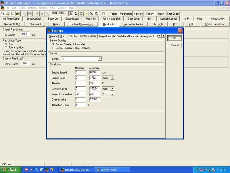

Here is the calibration just for the hell of it. Here is a screenshot of my sensor overlay dialog box.

Posts: 24169
I need some clarification. Are you saying that the Display and Sensors windows do not display the AF under high load?
MAke sure when you post a question, you put the whole question in the message...do not put half the question in the topic. Notice how different this sounds if all you read is the question you posted in the message body:
"They used to, but for some reason, when i upgraded to v120, i can only view the A/F at idle or low loads in "display" or "sensors". Is this some sensor overlay issue??"
Posts: 10652
There was some confusion here over when the lambda was not displaying (this first post mentions 'low load' in the title and then 'can only view at low load' in the post). We think you meant that it does not show at low load.
Anyhow, the likely cause is the TPS going below zero percent and the display criteria not allowing a number smaller than zero to be entered. We've fixed this for the next release, but in the meantime, adjust the TPS so that it shows 1% at idle.
