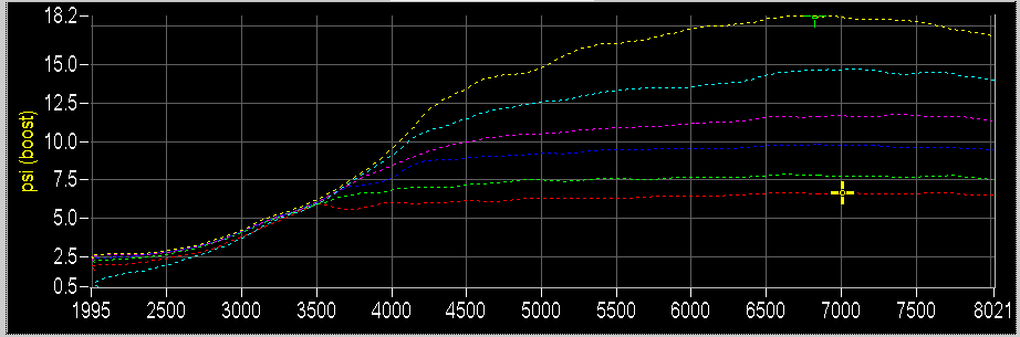

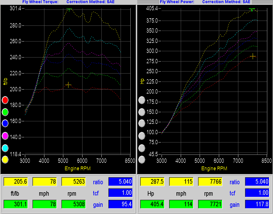

These dyno graphs show the difference in boost levels from running the boost control valve at 0%, 32%, 45%, 50%, 55% and 60% duty cycle.
Torque and power:

Manifold pressure:
boostcontrol-dyno2
