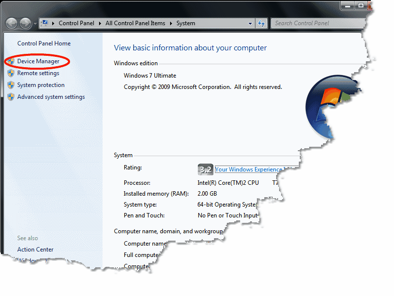

1.Open the control panel using Windows key and Pause-Break.
2.Open the 'Device Manager'.
windows7_usb_1

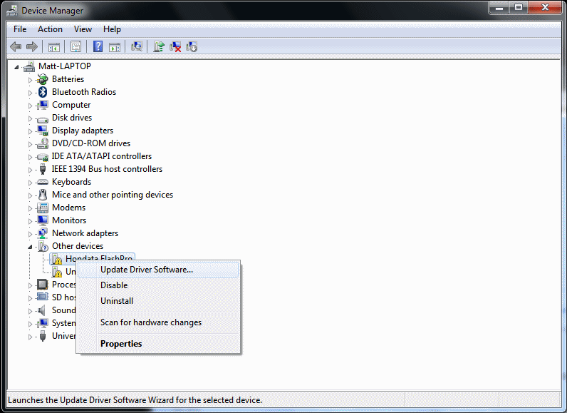

3. Right click on 'FlashPro' (FlashPro may be listed under "ECU Hardware (Hondata) or 'Other Devices') and select 'Update Driver Software...'.
windows7_usb_4

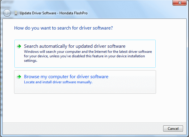

4.Select 'Browse my computer'.
windows7_usb_5

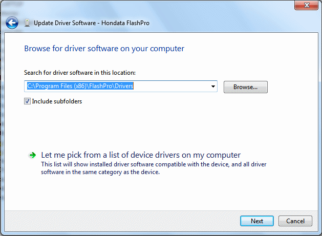

5. Tell Windows to look in the FlashPro installation directory.  Normally this will be 'C:\Program Files\FlashPro\Drivers' (Windows 7 32-bit) or  'C:\Program Files (x86)\FlashPro\Drivers' (Windows 7 64-bit).
windows7_usb_6

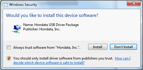

6. Confirm that you want to install the drivers.
windows7_usb_7

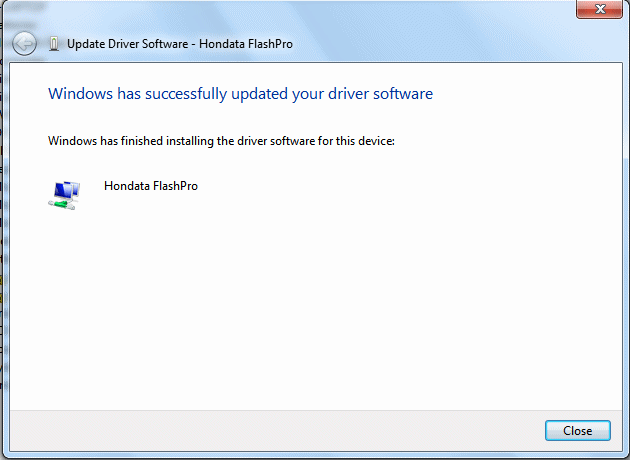

7. Windows will install the drivers.
windows7_usb_9
