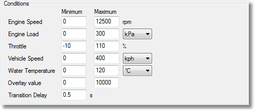

Overlay Conditions
In order to only show valid valid, overlay conditions can be used to eliminate sensor values when certain conditions are not met. The transition delay is the time delay between the datalogged value meeting the overlay conditions and the sensor values being recorded. This is to allow some time for the sensor value to settle. |
