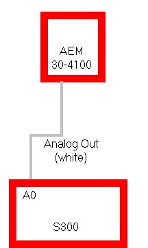

eg. Connecting a AEM 30-4100 with single analog output

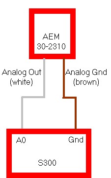

Note: In order to reduce the voltage offset between the ECU and wideband, use a heavy gauge wire for the wideband ground, keep the wideband ground wire as short as possible and ground the wideband in the same place as the ECU.
eg. Connecting a AEM 30-2310 with analog output and analog ground.
