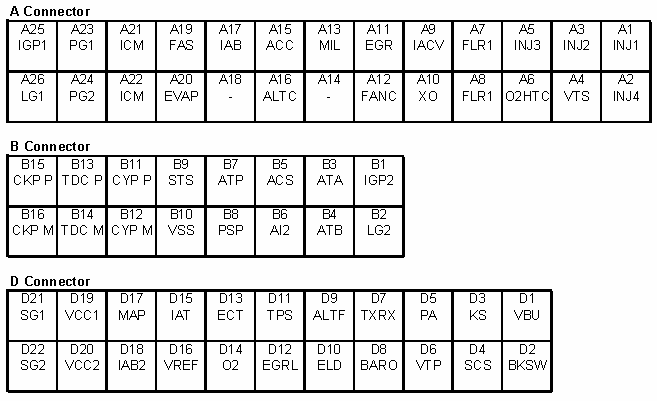

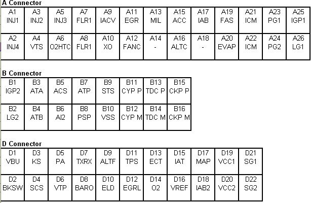

Connectors
Shown from the wire side of the ECU:
Shown from the ECU side of the connector:
Pin Description
IGP1
A25
Power from main relay
IGP2
B1
PG1
A23
Ground
PG2
A24
Ground
VBU
D1
Voltage back up
LG1
A26
Logic ground
LG2
B2
Logic ground
CYP P
B11
Distributor cylinder sensor
CYP M
B12
TDC P
B13
Distributor TDC sensor
TDC M
B14
CKP P
B15
Distributor crank sensor
CKP M
B16
INJ1
A1
Injector #1
INJ2
A3
Injector #2
INJ3
A5
Injector #3
INJ4
A2
Injector #4
VCC1
D19
MAP 5V
MAP
D17
Manifold pressure sensor
SG1
D21
MAP logic ground
VCC2
D20
TPS 5V
TPS
D11
Throttle position sensor
SG2
D22
TPS ground
IAT
D15
Air temperature sensor
ECT
D13
Water temperature sensor
VSS
B10
Speed sensor
ELD
D10
Electrical load detector
EGRL
D12
EGR lift
B6
Analog input #2
STS
B9
Start Signal
PSP
B8
Power steering pressure
BKSW
D2
Brake Switch
ACS
B5
AC Switch
VTP
D6
VTEC Pressure Switch
SCS
D4
Service Connector
FLR1
A7/A8
Fuel pump relay
ICM
A21/A22
Igniter output
IACV
A9
Idle valve
ACC
A15
AC Clutch
FANC
A12
Radiator fan control
MIL
A13
Check engine light
IAB
A17
Secondary intake runners
VTS
A4
VTEC solenoid
EGR
A11
EGR
O2HTC
A6
O2 sensor heater
EVAP
A20
Purge valve
ALTC
A16
Alternator
A10
Nitrous Output
TXRX
D7
Serial comms
