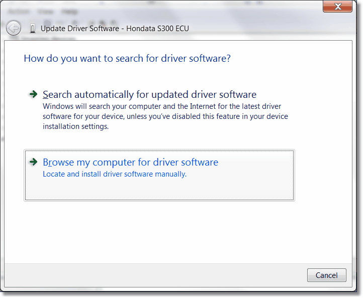

1. After selecting Update Driver Software... from the Device Manager you should see the following window. Click on Browse my computer for driver software.

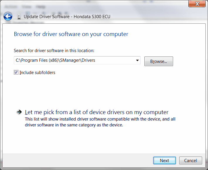

2. Use the Browse button to enter the path to the SManager software installation location. Normally this will be either C:\Program Files\SManager\Drivers (32 bit Windows) or C:\Program Files (x86)\SManager\Drivers (64 bit Windows).

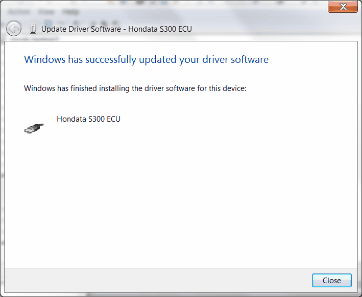

3. Windows will copy drivers, and should display the following message once finished.
