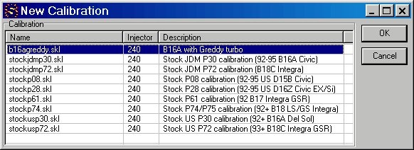

New Calibration |
The New Calibration window is a way of creating a new calibration from a pre-defined calibration.
To load a calibration select a calibration from the list and select 'OK', or double-click on the calibration.
Note: All the calibrations were tuned and tested by Hondata on vehicle setups are shown in the description column. These calibrations make a good starting point but usually require further tuning to run perfectly. |
