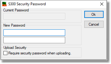

Setting a Security Password
A Security Password may be set from the Online -> Set Security Password menu.
The S300 must be connected to the laptop and the ignition needs to be switched on.
Entering a password Leave Current Password empty, as by default the security password is empty. Enter your new password twice to ensure that the new password has been entered correctly.
Changing Your Password Enter your current security password, or leave blank if no password has been entered, and enter your new password twice to ensure that the new password has been entered correctly.
Removing Your Password To remove a password enter your current password and leave the new password fields empty..
Upload Security Check Require security password when uploading to ask for the security password each time a calibration is uploaded to the S300.
