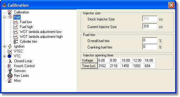

Calibration Window
The calibration window allows calibration parameters to be edited.
calibration-window
Note that different vehicles and calibration types will have different calibration parameters which may be edited.
Calibration Parameter Groups
Calibration parameters
Fuel parameters
Ignition parameters
VTEC parameters
VTC parameters
Closed loop parameters
Knock control parameters
Rev limit parameters
Idle parameters
Sensor parameters
Misc parameters
Ethanol Parameters
Traction Control Parameters

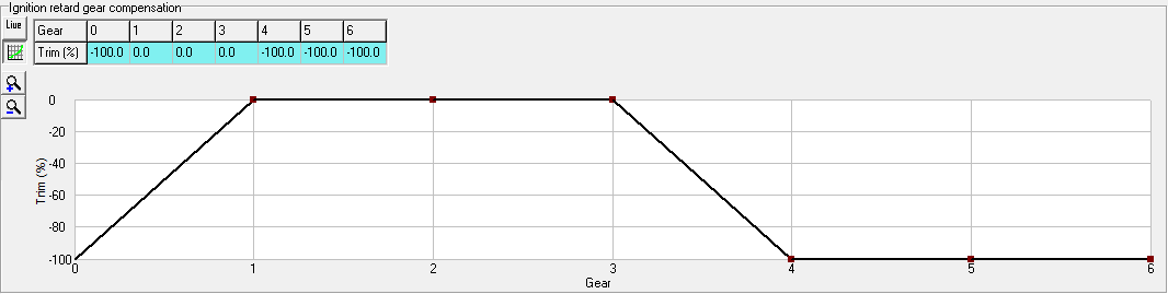

2D Graphs
calibration-2dgraph
Each table in the calibration window has the option of being displayed on a 2D graph.
