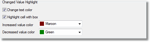

Changed Value Highlight Values in the Table Window may be highlighted to show editing changes.
Also see Changed Value Highlight
