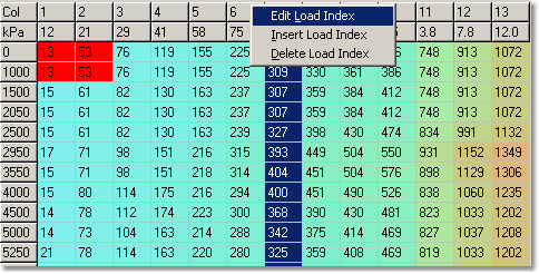

The Load and Rpm indices may be changed in the Table Window by right clicking on the load/rpm value.
Edit Index
Insert Index
This inserts a new index at the current row or column. All other indexes and table values are moved downwards (rpm) or to the right (load). The last index is removed.
Delete Index
This deletes the current index. All other indexes and table values are moved upwards (rpm) or leftwards (load). A new index is added at the end of the table.

e.g. changing the 1000 rpm index value for a fuel table
The 1000 rpm value is changed to 1100 rpm
The fuel value is now lower at 1100 rpm than before the change was made.
