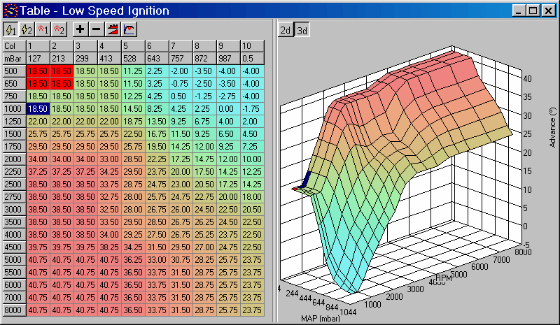

Table Window
The table window contains the main tables from the ECU - ignition and fuel.
tablewindow

Grid View
The area on the left of the table window shows a numerical representation of the current table.
Selecting Cells
The mouse may be used to select multiple cells by clicking and dragging.
The arrow keys may be used to select a single cell, or with conjunction with the space bar, select a number of cells.
The menu item 'Select All' (Ctrl+A) selects all the cells in the table.
Clicking on the topmost row will select all the cells in the column. By clicking and dragging on the topmost column, a number of columns may be selected.
Similarly, clicking on the leftmost column will select all the cells in the row. By clicking and dragging on the leftmost column , a number of rows may be selected.
2D Graph: The left mouse button may be used to select a range of cells.
2D & 3D Graph: Shift + left mouse button will select a row.
2D & 3D Graph: Control + left mouse button will select a column.

Graph View
The right side of the table window contains a 2D or 3D representation of the current table. Mapping points on the 2D graph may be altered by clicking on the rectangles and dragging up or down. On the 3D graph clicking will select an area on the Grid View.
