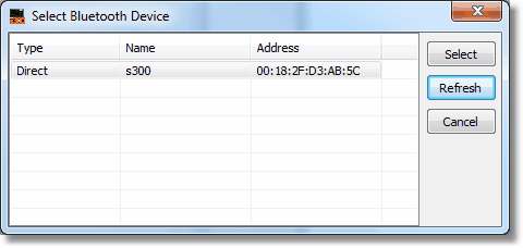

The Select Bluetooth Device window will be shown. Windows will remember previously discovered s300s, but will not find new s300s unless you use the Refresh button.

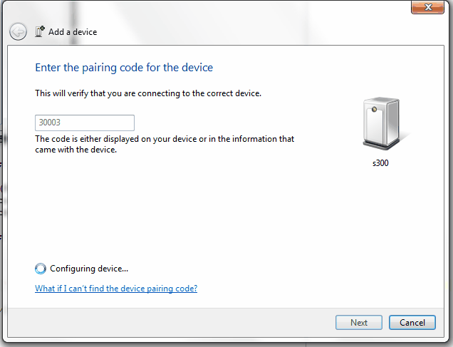

Selecting the S300 will connect to the S300. If the S300 has not been paired to the laptop, then Windows go through the pairing process. The pairing code defaults to the serial number of the s300, and can be changed via the S300 / Bluetooth window.
