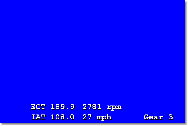

Export Movie allows you to export a datalog recording as a avi movie file. The movie uses a blue background which may be merged with in-car video footage to create a video overlap of engine parameters over the in-car footage.

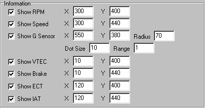

Information
This allows each datalogging parameter to be enabled/disabled and positioned on the video frame.

Output Example
