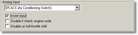

Input
Arming Input - specifies which ECU pin is used to arm the nitrous/aux output.
Invert input - reverses the state of the arming input.
Disable if check engine code - disables the output when there is a check engine code.
Disable on full throttle shift & launch control - disables the output when the full throttle shift rev limiter or launch control rev limiter is in operation.

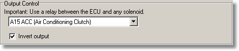

Output
Output - specifies which ECU pin is used for the output.
Invert output - reverses the states of the output.

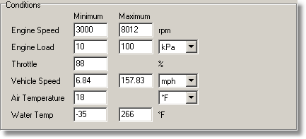

Conditions
All the conditions must be met in order for the output to be activated.
Engine speed - specifies the minimum and maximum rpm.
Engine load - specifies the minimum and maximum engine load.
Throttle - specifies the minimum throttle opening.
Vehicle speed - specifies the minimum and maximum vehicle speed. Note that setting the maximum speed to 255 kph (158.45 mph) disabled the maximum speed test.
Air temperature - specifies the minimum intake air temperature.
Water temperature - specifies the minimum and maximum coolant temperatures.
Note that not all these conditions will be available, depending on the function selected.

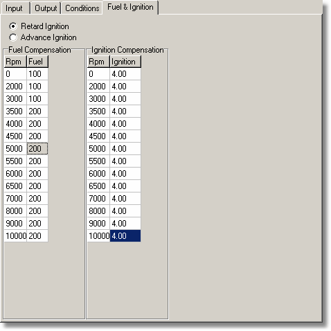

Fuel & Ignition
The above example will remove fuel and retard the ignition timing by 4 degrees when activated.

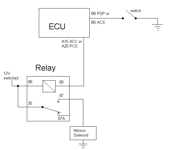

Output Control - specifies which ECU pin controls the nitrous solenoid. Important: the ECU cannot sink enough current directly to control a solenoid. A relay must be used between the ECU and solenoid to prevent damage to the ECU.

Fuel & Ignition - specifies changes to fuel and ignition when nitrous is activated.
The maximum retard is 40 degrees, and the ignition timing can be retard to a maximum of 10 degrees BTDC.
Do not make nitrous changes without using a wideband lambda meter to determine the correct air/fuel ratio. As a general guide, the following extra fuel is necessary:
With nitrous control it is possible to remove fuel and/or advance ignition timing by using negative values. This is useful when using water/alcohol injection.
