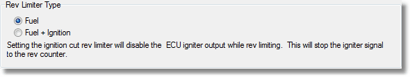

Rev Limiter Type Select fuel or fuel and ignition based rev limiter.
The stock and recommended setting is a Fuel only rev limiter. By selecting Fuel + Ignition, the ignition is also cut when the rev limit is activated.
Important Note: Since the ECU igniter output is disabled when the ignition limiter is in effect and the stock tachometer is driven from the igniter, the tachometer will not work when the ignition cut rev limiter is in operation.
