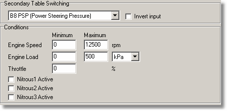

Dual Tables - using the power steering input as the activation input, the secondary tables can be switched on the fly for high/low octane tables etc. Note the conditions are as broad as possible so that the tables will activate based on the switch.

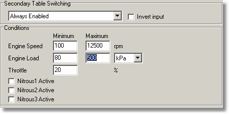

MAP / TPS switching for ITBs - by tuning the primary tables using TPS and the secondary tables using MAP, it is possible use the TPS based tables at low load, and switch to the MAP based tables at high load. Note that no input switch is used by setting the input to 'Always On'.

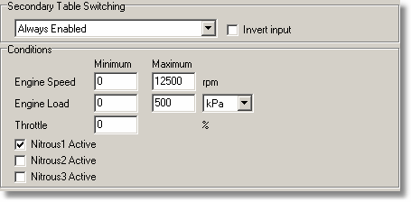

Nitrous Fuel - the secondary table fuel and ignition settings are be used when nitrous is active. The nitrous conditions determine when to switch nitrous on, so the secondary tables conditions should be made as broad as possible. |
