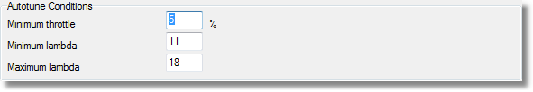

This tab contains settings for autotune, which uses feedback from a wideband lambda meter to adjust the fuel tables.
Minimum throttle is the minimum throttle opening for autotune adjustments to be made.
Minimum lambda is the minimum lambda value for autotune adjustments to be made.
Maximum lambda is the maximum lambda value for autotune adjustments to be made.

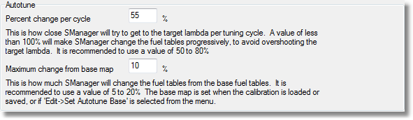

Percent change per cycle determines how close the ECU will try to make the lambda in each tuning cycle.
Maximum change from base map limits the changes that autotune can make over the starting map. |
