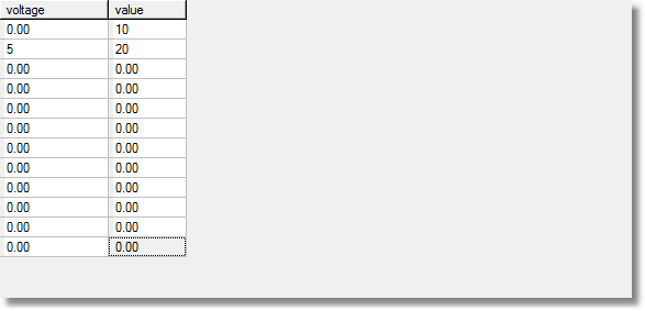

Pins D12 and B6 can be used as a 0-5V analog inputs. See Analog Input 1 and Analog Input 2
Conversion Table - specifies the voltage / value relationship.

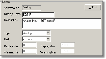

In order to view and graph the analog input, set the 'analog' sensor unit to Custom (decimal) or Custom (Integer). The Display Name is used as the graph label. |
