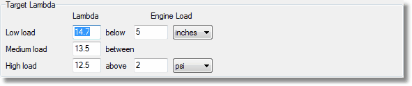

This tab contains settings for the display of the target lambda, which is used to determine the fuel change if a wide band lambda meter is used while datalogging.
The target lambda for tuning over three different load areas. The Low Load Target Lambda is used when the engine load is below the low engine load value. The Medium Load Target Lambda is used when the engine load is between the low and high engine load values. The High Load Target Lambda is used when the engine load is above the high engine load value. |
