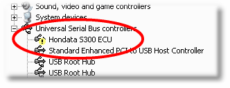

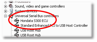

2. In the Device Manager, find the Hondata S300 ECU entry. It normally is under Universal Serial Bus Controllers, but may appear under Other Devices. You will need to click on the + to the left of Universal Serial Bus Controllers to expand the list. USB Drivers Installed Correctly
USB Drivers Not Installed
If a yellow exclamation appears next to Hondata S300 ECU, then the USB drivers need to be manually installed. Proceed to the next step.
